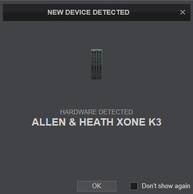

STEP 3 : VirtualDJ Setup
Once VirtualDJ is launched, a Connect window will appear to enter your virtualdj.com account credentials.
A Pro Infinity, a Plus Controller or a Pro Subscription License is required to fully use the Xone K3. Without any of the above Licenses, the controller will operate for 10 minutes each time you restart VirtualDJ.
Click OK.
The device is now ready to operate.
