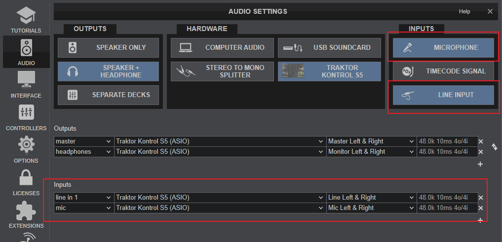

Alternatively, any (or both) of these inputs can be added to VirtualDJ Audio setup and routed to a VirtualDJ Deck as Microphone and Live Input, providing Volume, EQ, Effects etc. controls but at the same time sacrificing one or two VirtualDJ Decks.
In this case, the AUX button [15] at the top panel needs to be turned off.
Open VirtualDJ Audio Setup and click on the MICROPHONE and LINE INPUT buttons at the top-right of this window for VirtualDJ to add 2 extra lines for these inputs.
Make sure the linein 1 is assigned to the S5 audio interface and the Line Left & Right Channels as shown in the image above.
Make sure the mic is assigned to the S5 audio interface and the Mic Left & Right Channels as shown in the image above.
After that, you can ..
- Enable Line Input to any Deck (or use SHIFT+PFL [3] buttons. See Line Inputs in VirtualDJ Manual
- Control Microphone input. See Microphone Input in VirtualDJ Manual
Note: By disabling the hardware Mic/Aux routing (AUX button turned off) and adding these inputs in VirtualDJ Audio setup, your mix will be recorded along with the signal of these inputs.
