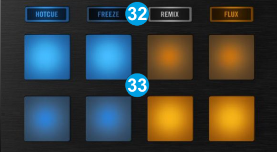

PERFORMANCE PADS
The 8 Pads offer various functions, depending on the selected Pads mode. Each of the 4 Pad mode buttons offers 2 individual modes. One with the press of the mode button, and an additional mode by holding SHIFT. The 8 modes represent a page of the PADS section on the default VirtualDJ GUI.
  1. PAD MODE. Press any of the 4 available Pad mode buttons to set the Pads to one of the following modes
    Primary modes :
    [HOTCUE] : Hotcues page
    [FREEZE] : Loop Roll page
    [REMIX] : Sampler page.
    [FLUX] : Stems +FX page
    Secondary modes :
    SHIFT+[HOTCUE] : KeyCue page
    SHIFT+[[FREEZE] : Slicer page
    SHIFT+[REMIX] : BeatJump page
    SHIFT+[FLUX] : Stems page
    All the above pre-assigned pages can be changed. See VirtualDJ Manual
    Note : When a primary mode is selected, hold this mode button down and then use the Loop Encoder [23] to adjust the 1st Parameter (if available) of the selected Pads page.
  2. PADS. The 8 RGB Pads offer different functionality depending on the selected mode.
Read further details about Pads in the VirtualDJ manual
