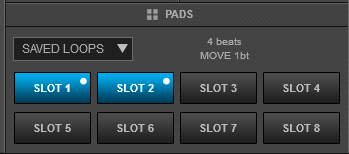

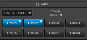

Saved Loops mode
Press the Loop Mode button twice (or once if the selected mode was Manual Loop ) to set the Pads to Saved Loops mode (the led of the Loop button will become pink). The Saved Loops page will be then selected and displayed in the Pads section of the VirtualDJ skins.
Saved Loops Page - VirtualDJ default skin
Saved Loops Page when SHIFT is pressed - VirtualDJ default skin
This mode offers the ability to save up to 8 Loops to individual Loop Slots.
Press any Pad to save the current Loop at the current track’s position (of the selected size in beats) to the relative slot. Hold the same Pad down for more than 1 second to delete the Saved Loop .
When a Loop slot is saved, press the corresponding Pad to load (prepare) the Saved Loop .
If the track’s position is before the Saved Loop point, the Loop will be enabled but the track will not jump to that position (Prepare status). Use the same Pad to disable the Loop .
Hold SHIFT down and then press one of the lower Pads to load the Saved Loop , but also jump to that position.
Use the PARAMETER < and > buttons to half and double the size of the triggered Loop .
Hold SHIFT down and then use the PARAMETER buttons to move the Loop forward/backwards by 1 beat
