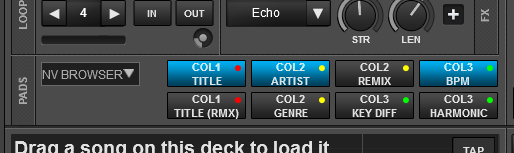

Browser Display Options
VirtualDJ provides the ability to adjust the content of the 3 Browser columns in the Browser view, Go to VirtualDJ Settings ->OPTIONS tab and select the CONTROLLER sub-category. Find the NV Settings at the top of the list (available only when the NV is connected).
VirtualDJ OPTIONS - NV Settings

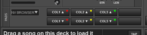

A special Pad page (available only when the NV is connected) named as NV Browser will be also available to use and/or assign to a Pads mode, providing quick access to Column sort Orders
NV Browser Pad Page
