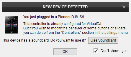

A window will appear next, to verify the proper detection.
Click on the “DJM-S9” button and VirtualDJ will automatically create and apply the pre-defined audio configuration using the built-in audio interface of the Pioneer DJM-S9
Set the SOURCE selector at the top panel for DECKs to the USB position A or B depending on the port you have used to connect with your computer.
Click to OK.
The unit is now ready to operate with VirtualDJ.

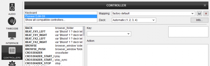

MIDI Operation
The unit should be visible in the CONTROLLERS tab of Config and the “factory default” available/selected from the Mappings drop-down list.
Find more details at
https://virtualdj.com/wiki/VDJ8script.html
