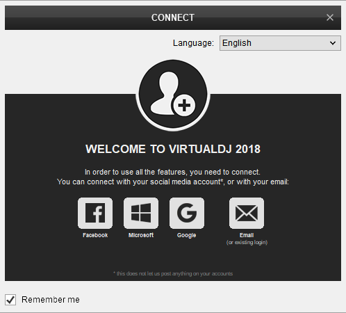

VirtualDJ Setup
Once VirtualDJ is launched, a Connect Window will appear to login with your virtualdj.com account credentials.
A Pro Infinity or a Pro Subscription License is required to fully use the Pioneer XDJ-XZ Without any of the above Licenses, the controller will operate for 10 minutes each time you restart VirtualDJ.
Click to OK

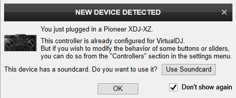

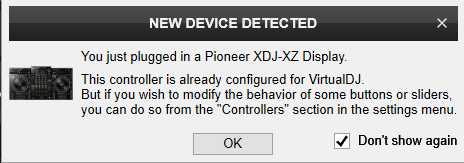

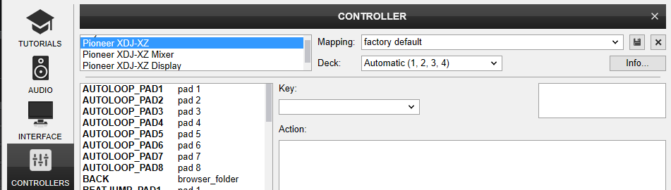

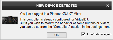

MIDI Operation
The unit should be visible in the MAPPING tab of Config as 3 separate units (the main unit , the Mixer and an additional one for the Display) and the “factory default” available/selected from the Mappings drop-down list for all units. The factory default Mapping offers the functions described in this Manual, however those can be adjusted to your needs via VDJ Script actions.
Find more details at https://www.virtualdj.com/wiki/VDJ8script.html
