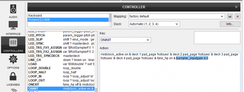

The TR Sampler Output in the DJ-808 is a mix of the Hardware TR Sampler and the VirtualDJ Sampler and a sequence can include a combination of both. We found the TR Sampler input signal a bit low during our tests, so we increased its input gain. If for any reason you need to change this (decrease or increase), and you find that the Software and the Hardware Samples are not in the same output level, you can modify the multiply parameter (sampler_inputgain value) in the ONINIT key of the Roland DJ-808 mapping.
TR Sampler Input - Gain Adjust
