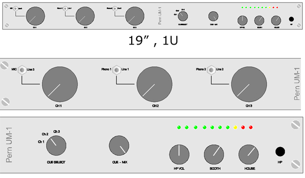

* 1st step, build a reference mixer. *
Since i cant get my hands on an original UREI 1620 but really want to hear myself how it sounds etc, i will build one and have as a sound reference for the others.
It will be built from the original schematics but with some minor changes:
- Built in a 19" 1U box
- Added CUE - MIX function
- Added mono LED VU meter. Might be stereo, not sure yet.
- Added Effect send for Mic
- Removed EQ
Each channel have a 2 input select swich. So available inputs are:
- 1 Mic
- 2 Phono
- 3 Line
This is how it will look like (But all LEDs will be blue ones) :
- Removed EQ
- 1 Mic
- 2 Phono
- 3 Line

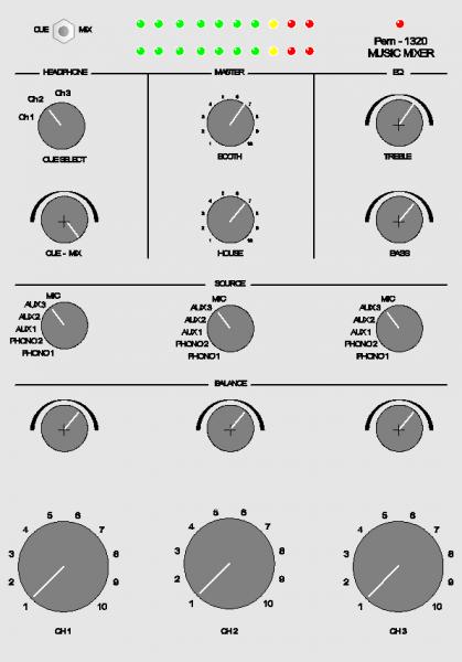

* Rotary Reference mixer. Part 2 *
After googling a lot i have learned that the UREI EQ affects the sound even when it's in "0" position. So i have to add that, and then i will add the balance funtion and source select also to get a 98% TRUE 1620. But this can't fit in a 1U box and at the moment i don't want to do a 2U.
So i have decided to do a small desktop version of it since i actually need one. This will also be MUCH cheaper to do. The dimensions are 160 * 220 * 50 mm.
This is how it will look:
(* HP Vol is located on the front)

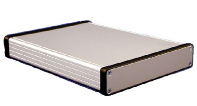

And this is the box i will use:
Now it's time to start up the PCB CAD ;-)

Can you implement a flip switch for using or not using the transformer on the balance output ?
geposted Fri 09 Jan 09 @ 9:57 am
What would be a nice touch on a later model (mk2 maybe) is replacing the Led's, with 2 old fashioned looking meters.
Then that would make it look really nice, but I guess I'm jumpin' the gun here abit, lol
geposted Fri 09 Jan 09 @ 10:00 am
No,
- Balanced, No transformer
- Balanced using transformer
Are 2 complete different designs. I have to choose one of them.

In this test version the BOOTH output will be 100% as the original schematic, so no balanced output there. For HOUSE i will do 2 different PCB designs, with and without trafo. I'm not just thinking of my own testing purpose, also if anyone else want to use the design but doesn't want the transformers. 2 HQ transformers is about $ 125. about $ 110 more in material cost than the version without it. And a HQ transformer doesn't affect the sound. A bad one does affect the treble a little bit.
But when i build the 19" 3U rotary mixer after this one, everything will be in modules. Then you can pick and choose whatever you want. Including mods/extensions that will also work with both 1620 and 1620 LE.
