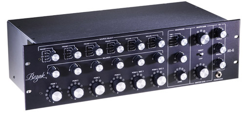

Yes, i will. After i built the Desktop version i will start on the 19" version. I will be a "traditional" (Bozak/UREI) design but built in modules . It will also have an "extension box" so that you can have things like 3-band EQ, X-Fader, MIC amp with EQ. VU/PEAK meters etc...
The front of it will look about 98% like Bozak AR-6 :

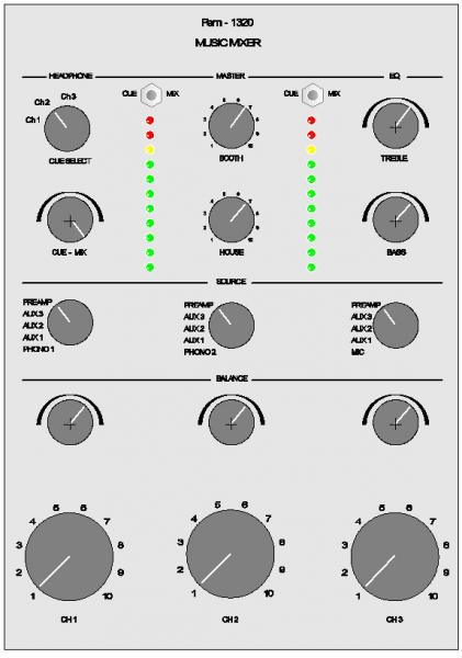

While designing the PCB i noticed that i need the space at top for input connectors at the rear, so i moved the LEDs. I also added an extra CUE - HOUSE switch for the LEDs so there are now one per LED channel. so the LEDs can now show CUE (Stereo), HOUSE (Stereo), or one CUE (MONO) an the the other HOUSE (MONO).
I also changed the source select function. PHONO 1 + 2 + MIC are now fixed, but i added PREAMP select. So if you don't use PHONO or MIC you can also use the connectors as extra AUX (Line) inputs.
geposted Sun 11 Jan 09 @ 10:49 am
Personally I prefer this LED set up to the previous one Pern..looking good

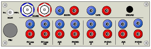

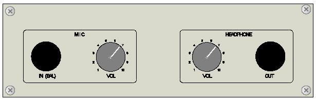

** Status Update **
I have had a lot of suggestions etc on the design and i have now updated it to something that i think is what a lot of people could use. One of the biggest request was to add a third PHONO input, so that is added. The source select is changed to better work with the design also. And i have moved the MIC vol to the front also. Master/EQ/HP location on the top is also changed.
Specs at the moment are:
INPUTS:
- 1 MIC (Balanced)
- 3 PHONO
- 3 ( 6 ) AUX
OUTPUTS:
- HOUSE (Balanced / Unbalanced - selected via switch in the rear)
- Booth
- Tape
- FX Loop In-Out
This is how it looks now:
Front:
Rear:
INPUTS:
- 1 MIC (Balanced)
- 3 PHONO
- 3 ( 6 ) AUX
OUTPUTS:
- Booth
- Tape
- FX Loop In-Out
Front:
Rear:
geposted Wed 14 Jan 09 @ 2:43 am

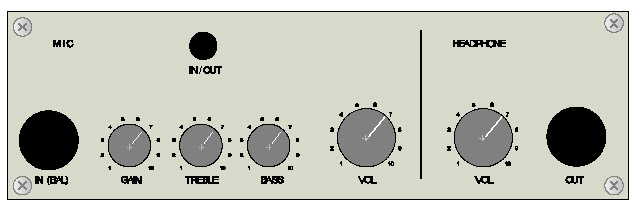

And here is the FRONT option with MIC EQ etc:
geposted Wed 14 Jan 09 @ 3:20 am

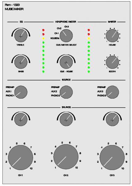

* Status update *
Made some changes in functionality.
- Balance function removed but it's very easy to add for people who wants it.
- CUE function changed to switches. There is also a CUE summing bus added.
So if you want more input channels it's very easy to add them.
- LEDs removed an nice VU-meters added, i finaly found some nice ones at a good price.
Components ordered and PCB design in progress.
geposted Sun 25 Jan 09 @ 5:27 am
wonderful work
geposted Sun 25 Jan 09 @ 8:22 am
x-Static wrote :
wonderful work
Yep, sure is
geposted Sun 25 Jan 09 @ 8:26 am
