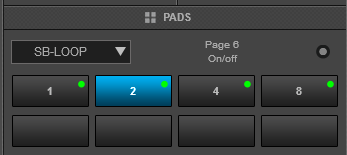

Auto Loop mode
Press the AUTO Loop mode button to set the PADs to Auto Loop mode. The special SB- Loop page will be loaded to the Pads section of VirtualDJ GUI.Each one of the 4 pad triggers a seamless Loop of a different size (in beats) depending on the selected page (from 1/32 beat to 8 beats).
Hold SHIFT and then press the same Pads to trigger Loops larger in size than the ones offered from the Loop page (from 1/2 beat to 128 beats).
Hold the AUTO Loop mode button down and then use Pads 1/2 to decrease/increase the 1st Parameter of the SB- Loop page (selects previous/next Loop page)
Hold the AUTO Loop mode button down and then use Pads 3/4 to decrease/increase the 2nd Parameter of the SB- Loop (selects previous/next Loop trigger mode)
Roll mode
Hold SHIFT and then press the AUTO Loop mode button to set the PADs to Roll mode. The led of the button will blink to indicate this mode and the special SB- Loop Roll page will be loaded to the Pads section of VirtualDJ GUIEach one of the 4 pad triggers a momentary (while pressed) Loop Roll of a different size (from 1/32 to 1/4 beat). Hold SHIFT and then press the same Pads to trigger a Loop roll of 1/2 to 4 beats. When the Pad is released, the track will resume playing from the position it would have been if the Loop was never triggered.
This Pad page has no parameters
