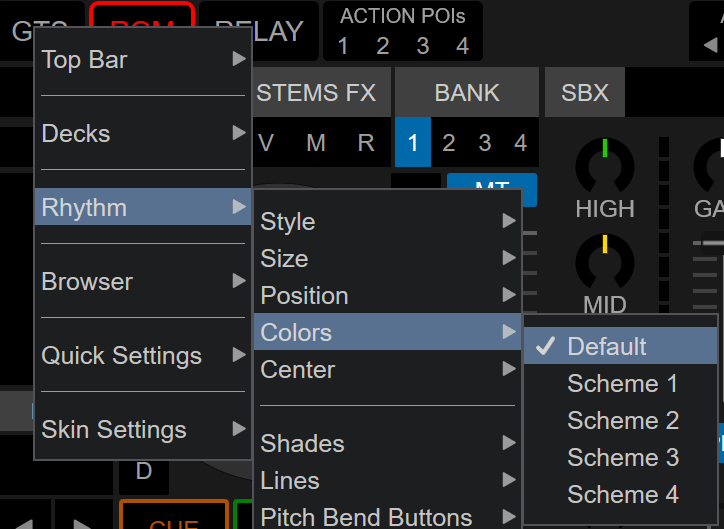

FYI with the new VDJ 2026 beta and skinwaveformtype shapes, it's very difficult to read the generated lyrics
Skin has been updated, and now it's also possible to choose between 5 different color schemes for the shapes waveforms.
"Default" is the default VirtualDJ colors.
35%
