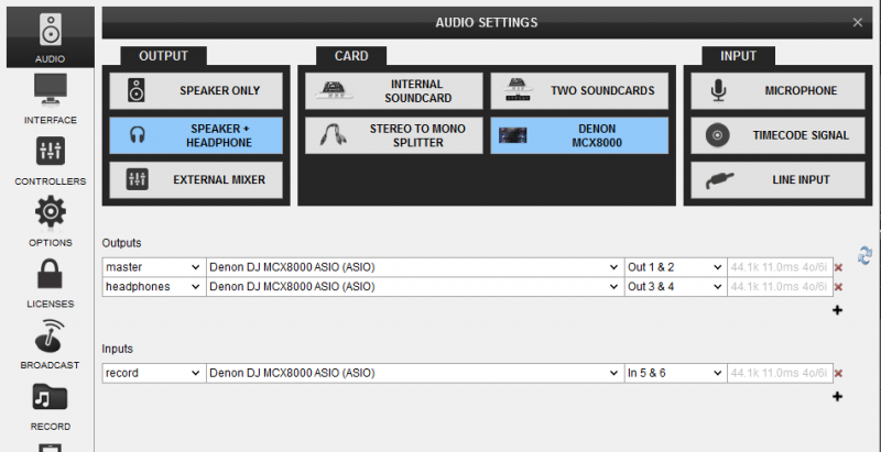

Recording & Broadcasting
The unit offers the ability to record the Master Output along with the Microphone and LINE Inputs directly from VirtualDJ record button (in the Master center panel). The dedicated Recording input channel is already pre-configured, so no further adjustments need to be done.
You will probably find the recording level quite low though, so you may want to increase the USB output level sent from the MCX8000, by visiting the UTILITIES of the unit.
Hold down the UTILITY/VIEW button, locate the USB Output Level setting and change it from the default 0db to around 10db.
Note : The recorded output includes any source routed to the Mixer , including media played via the Engine application or other analogue media sources connected to the LINE Inputs when the top switchers are set to the relative position.

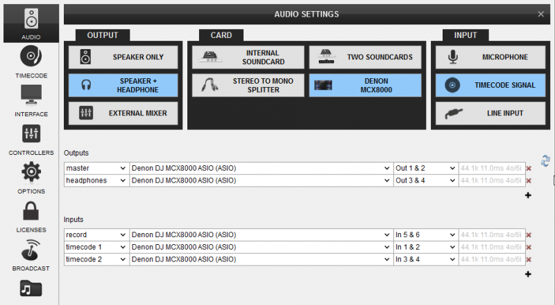

Timecodes (DVS)
The Denon DJ MCX8000 is offering DVS (Timecoded CDs and Vinyls) Support,
  • Connect your Timecode devices to LINE 3 and/or LINE 4
  • Place the PC/ENGINE/LN switches from the top panel to PC position for Mixer Channels 3 and/or 4
  • Open VirtualDJ Settings ->AUDIO tab ans press the Timecode SIGNAL button from the INPUT tab
  • Click to APPLY
Audio configuration with Timecodes
Use the Timecode On/Off buttons that will be offered on the Decks (or in the Scratch panel for the 4 Decks default VirtualDJ GUI) to enable/disable Timecode control or use the Timecode signal to control a different Deck (e.g. swap Timecode control for Left decks when the 4 Decks GUI is selected)

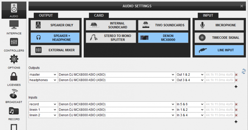

LINE INS
The same LINE Inputs 3 and 4 can be also used to send audio signal from an analogue media source connected at the rear panel to VirtualDJ for processing.
  • Connect your analogue media devices to LINE 3 and/or LINE 4
  • Open VirtualDJ Settings ->AUDIO tab and press the LINE INPUT button from the INPUT tab
  • Click to APPLY
Audio configuration with Line Ins
Use the LINE IN On/Off buttons that will be offered on the Decks (or in the Scratch panel for the 4 Decks default VirtualDJ GUI) to enable/disable Line In routing to a VirtualDJ deck.
This will provide the ability to synchronize BPM with other decks, use Effects etc.
