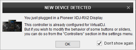

Once VirtualDJ is launched, a Connect Window will appear to enter your virtualdj.com account credentials.
A Pro Infinity or a Pro Subscription License is required to fully use the Pioneer XDJ-RX2 Without any of the above Licenses, the controller will operate for 10 minutes each time you restart VirtualDJ.
Click to OK on both windows

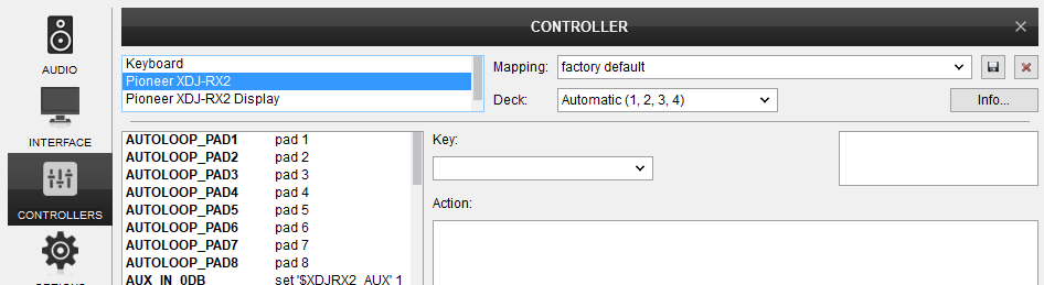

MIDI Operation
The device should be visible in the MAPPING tab of VirtualDJ Settings as 2 separate device (one for the main device and an additional one for the Display) and the “factory default” available/selected from the Mappings drop-down list for both units. The factory default Mapping offers the functions described in this Manual, however those can be adjusted to your needs via VDJ Script actions.
Find more details at https://www.virtualdj.com/wiki/VDJ8script.html

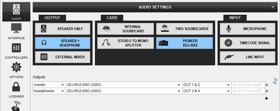

AUDIO Setup
The device has a pre-defined Audio setup and a special button in the AUDIO tab of Config to provide that.
Alternative audio configurations can be applied See Advanced Setup
