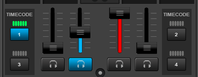

Use the Timecode ON buttons from the VDJ GUI to enable the Timecode controls to a VirtualDJ deck.
Timecode buttons - VirtualDJ Pro Default layout GUI
