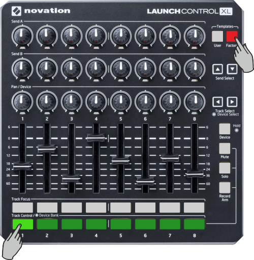

FACTORY TEMPLATE 1
When VirtualDJ starts with the Launch Control XL connected, the device starts on Factory Template 1 (default Template). You can select this Template anytime, by holding down the FACTORY button and pressing the Track Control button 1
