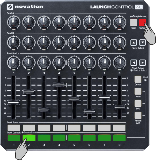

FACTORY TEMPLATE 2
Hold down the FACTORY button and press the Track Control button 2 to get the Factory Template 2
This Template is pre-assigned to control EQ Volume, Stems and Pads for Left/Right Decks.

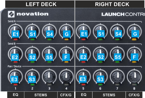

TOP KNOBS - EQ & Stems
KEY
ACTION
E1
Adjust the High Frequencies of the VDJ Equalizer.
E2
Adjust the Mid Frequencies of the VDJ Equalizer.
E3
Adjust the Low Frequencies of the VDJ Equalizer.
S1
Adjust the HiHat Stem
S2
Adjust the Vocal Stem
S3
Adjust the Instrument Stem
S4
Adjust the Bass Stem
S5
Adjust the Kick Stem
G
Adjust the Gain (pre-fader level)
F
Adjust the selected Color FX (Filter by default)

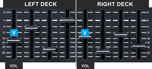

FADERS - VOLUMES
KEY
ACTION
V
Adjust the Volume of the Left/Right Deck

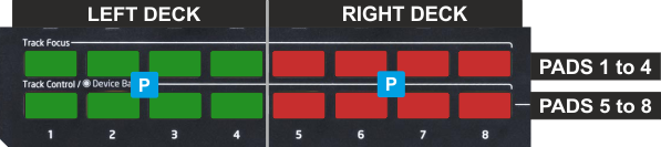

BOTTOM BUTTONS - PADS
KEY
ACTION
SHIFT ACTION
P
Trigger Pads 1 to 8 of the selected Pads Page for the Left/Right Deck. See Pads
Trigger the Shift-assigned action of of Pad 1 to 8 of the selected Pads Page. See Pads

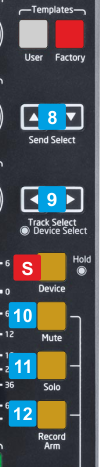

OTHER BUTTONS
KEY
ACTION
8
Use the Up arrow button to Swap Left Decks 1,3.
Use the Down arrow button to Swap Right Decks 2,4
9
Use the Left arrow button to select the Left Deck as default.
Use the Right arrow button to select the Right Deck as default
10
Select the next available Pads Page for the selected Deck
11
Select the previous available Pads Page for the selected Deck
12
Not used
