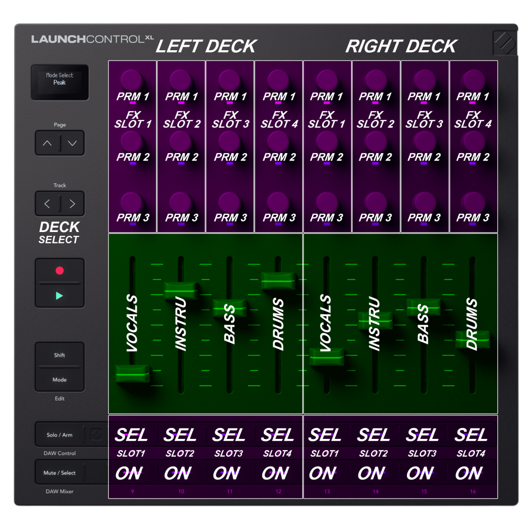

DAW Control
  • Press the MODE button once.
  • Press the "DAW Control" button once.
  • Press the MODE button once again.
The unit is now in "DAW Control" mode
This mode is pre-mapped to allow you greater control over Effects and Stems for Left/Right Decks:
  • Each column of encoders represents the parameters 1-3 of an effect slot which extends to the assignable buttons below the faders.
    Up to four effect slots can be controlled for each deck.
  • Press the "SEL" button(s) to select the next available effect for each slot. Hold down SHIFT and press "SEL" button(s) to select the previous available effect for each slot.
  • Press the "ON" button(s) to turn each effect slot on/off.
  • Press the LEFT "Track" button to switch the left deck between decks 1 & 3
  • Press the RIGHT "Track" button to switch the right deck between decks 2 & 4
