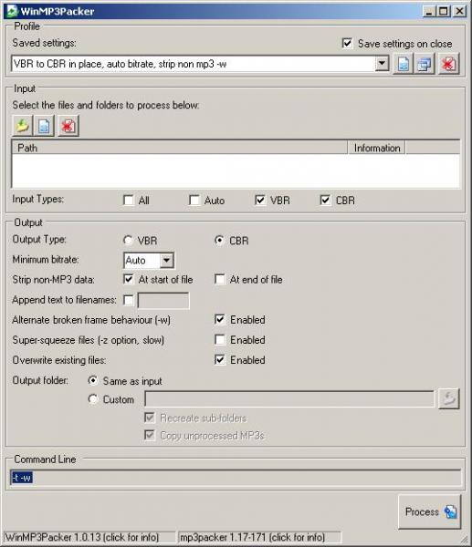

Hi all,
Seems that this has something to do with the VBR info writen in the header of the mp3 file. After lot\'s of experimenting I found a workable solution for this VBR \'issue\'.
Pass the VBR encoded files effected 2x trough the WinMP3Packer tool using the setting from the screenshot.
* 1st pass will strip out all header and tag info so it seems.
* 2nd pass it converts to the appropriate constant bitrate.
Loading them, VDJ will scand stor the appropriate bitrate again. You can freely use any plugin like scratch or brake etc without issues. The only downside of this all is that you will have to add any taginfo again...
- Ruud -
- Ruud -
