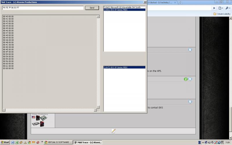

If someone can download this tool ... http://www.virtualdj.com/download/miditrace.exe
Run it from your desktop ... and post back the list of items in the right 2 boxes ... then I can start helping you ...

Sorry for getting back so late ... but great ...
Highlight the EKS XP-Series MIDI
In both boxes and press the Send button ...
Paste back the string off number/letters that comes up ...

here are the strings dj
B0 4A 00 00
B0 4B 00 00
B0 4C 00 00
B0 4D 00 00
B0 4E 00 00
B0 4F 00 00
B0 50 00 00
B0 51 00 00
B0 54 00 00
B0 55 00 00
B0 56 00 00
B0 60 00 00
B0 61 00 00
B0 4A 00 00
B0 4B 00 00
B0 4C 00 00
B0 4D 00 00
B0 4E 00 00
B0 4F 00 00
B0 50 00 00
B0 51 00 00
B0 54 00 00
B0 55 00 00
B0 56 00 00
B0 60 00 00
B0 61 00 00
geposted Wed 03 Jun 09 @ 11:38 pm

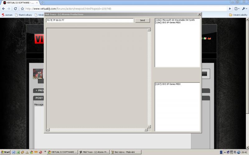

Not the strings I need ... please follow these instructions ...
Using the miditrace tool ...
Highlight the EKS XP-Series MIDI in both boxes and press the Send button ...
Paste back the string off number/letters that comes up ... do not move or press any buttons on the XP5.
geposted Wed 03 Jun 09 @ 11:43 pm
F0 7E 7F 06 01 F7
you mean this?
you mean this?
geposted Thu 04 Jun 09 @ 12:01 am
No the string that shows up after you push the send button. If no string shows the I need to contact EKS
geposted Thu 04 Jun 09 @ 12:06 am
when i push send nothing happens
geposted Thu 04 Jun 09 @ 12:23 am
this comes up at the top F0 7E 7F 06 01 F7
and i click send and nothing happens.
first of all i click the eks xp-series at the top the then one below then click send and nothing happens
geposted Thu 04 Jun 09 @ 12:41 am
