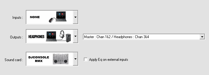

Ok, then your soundcard settings are not correct.
Check an make sure you are using - INPUTS - None, OUTPUTS - Headphones, SOUNDCARD - 4.1 Soundcard -- see if you can play music using just the skin ... then we can go from there...
geposted Mon 01 Jun 09 @ 10:07 pm
This works.
What's next?
geposted Mon 01 Jun 09 @ 10:43 pm
So how do I configure the soundcard to make the RMX work?
