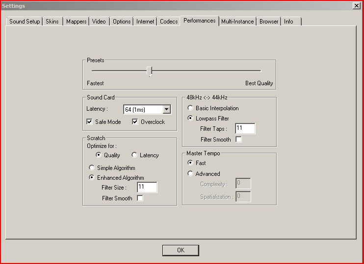

I was trying out all the functions on v6.01 and I noticed that when I click the little box to reset the pitch slider the music distorts alot. You guys should try it out and you will know what I'm talking about. If it doesn't happen to you guys then It's gotta be my comp or settings.
Kindly give some feed back ..............thanks

Check your latency in VirtualDJ / sound card

yeah, I did that already with many different confiurations
geposted Thu 04 Jun 09 @ 3:06 pm
So which value do you use?

Put the latency on auto and try it out, also try unticking safe mode and overclock.
Had midi noise on my rmx till I killed the safe mode and overclock, all good after that.

My Vista system is the opposite, so it does vary between systems, but I think the latency at 64 was his issue, what do u think??

Latency - AUTO (Latency for the RMX is controlled in the Hercules Control Panel, you are fighting those settings if you use anything different in VDJ)
Uncheck the Overclock and Safemode.

I agree. I have the same issue when I enable Safe Mode so uncheck it.

This could explain the issue that I was having when I was cueing up a track while the other deck was already playing. I will have to uncheck the boxes and see if it works better. If this works I may switch back to version 6.0. Thanks for the info guys.

since I use my keyboard to play the tracks if switch it to auto I wont get a quick start. I will me late when I want to beat mix.

Then change the latency in the RMX control panel ... not VDJ.
