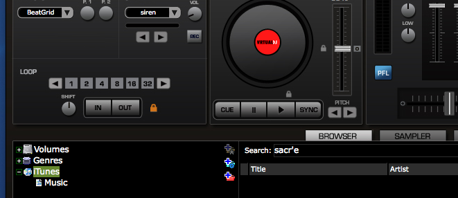

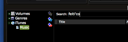

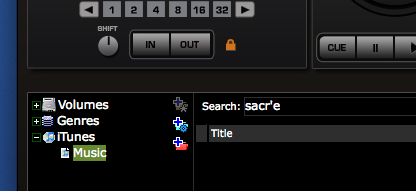

Many French and Portuguese/Brazilian words have accents, for example: CE SACRÉ PIANO, FEITIÇO DE ORAÇÃO
If I type \\\"Sacré\\\" in VDJ search box, VDJ will write the word in a wrong way and so will not show me results.
If I type Oração, I will have the same problem etc.
Is there anything I could do to fix the problem ?
Thanks
Thanks

I have an iMac24 ", so I use it with its original keyboard. To make it international, I installed this software: http://www.brockerhoff.net/usi/
Yes, I do need to press 2 keys to get the "é "key but I think this is not the problem.

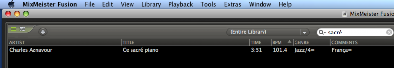

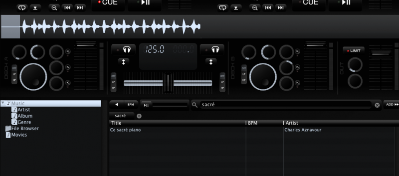

For example, why do I have no problems when typing to search in MixMeister Fusion Mac, Disco XT Mac, DJ Pro Advance from Visual DiscoMix ( under Bootcamp / Windows, Pages, Office for Mac etc ?
Here are some screenshots:
That's the reason because VirtualDJ reads both keys separately for the moment and not together.
Currently, I can only advise you a copy_paste of these special letters in the search field. With this solution, it will be recognized in the search field.
