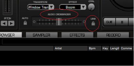

In VDJ video options, choose link video crossfader to audio crossfader ;)

That did sound like the most logical advice. I tried that before I first posted and it didn't work. It would only make a diference on the mixing mode not the video mode.

Click on the Link icon to Link the crossfaders.
Then click on the Croosfader Text to toggle between Video and Audio Crossfader. Choose what you like.
Note. If you use Video crossfader you actualy dont move the Audio crossfader but if you move the Audio Crossfader the Video crossfader moves too. So it's better to choose Audio crossfader.

Thanks DjDad!!! That was it. I knew to lock them together but didn't know you could toggle between the 2 by clicking the words. Thanks again.

Yes,DJ Dad. Thank you very much. I was having the same problem. However, I'd like to say that Atomix could do a better job at explaining these things in the user manual. This is what the manual explains regarding the matter:
Video crossfader linked to Audio crossfader –This option allows VirtualDJ to link to the audio crossfader for controlling video crossfades. If unlinked (unchecked) the video crossfade can be controlled using the video crossfader on the Video panel.
With all due respect, that is a terribly insufficient and confusing explanation. DJ Dad thank you for using a picture and making it easy to understand. I'm very excited about purchasing this software. Sorry, I don't mean to be a jerk. If I missed the instructions in an other part of the manual, then I should eat my shoes. Cheers.
