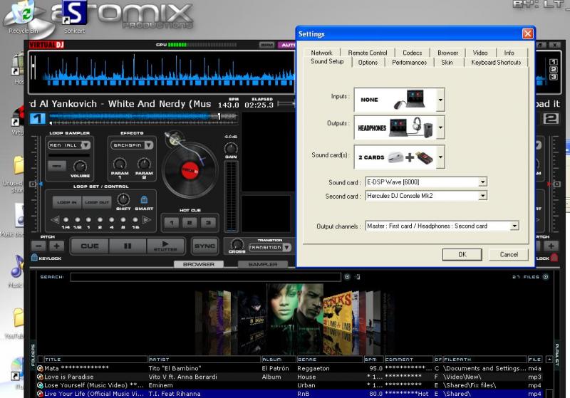

I\'m using an mk2 controller my confg. setting in VDJ are set as per the image below.
You do hear the two decks through your headphones at first, this is what I did to fix it.

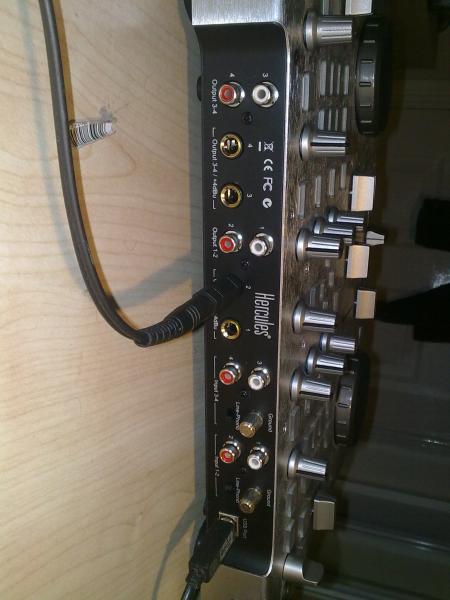

problem resolved. I plugged the headphones into output jack number 1 on the back. Its in the middle. All working now and happy. I can hear cue music. I can only hear sound from oneside of the headphones, is this normal?

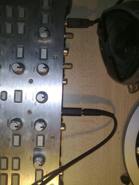

This is where i connected the head phones, my settings are still the same as in the original screen shot. I hope this can help users i the future with the same problem.
As far as i'm aware its time to /thread, although i'm still not sure if your supposed to hear music from one side of the head phone or not?
Thanks for all your help guys, thank you very much.
Dan
Oh yer, i uploaded the pictures from my phone while using it, technology is SO clever nowadays.

Glad to here you have managed to find a solution that suits you.
BTW the headphone signal will only be mono from that jack. Be carefull with the headphones you use as they need to be fairly high impedence units . The jack you have plugged into is not designed to drive headphone loads so go easy on the volume or you could damage your unit.
happy mixing
Daz
happy mixing
Daz
geposted Wed 11 Nov 09 @ 4:09 am
Dazmax wrote :
Glad to here you have managed to find a solution that suits you. BTW the headphone signal will only be mono from that jack. Be carefull with the

You better should use the headphone jack, NOT the line ot with an 6,3 adapter. You just get only the left or right channel (because only one plug / Mono).
You can damage your headphone. And the connector is not correct because you do not can use stereo plugs in mono. Thats everytime a problem.
I think the correct one s on the front side ?

A little knowledge goes a long way.
When using VDJ in "2 cards" mode, it uses the first output pair of each card, in this case, the front output of the onboard card and Output 1/2 of the Rmx.
As the Headphone ouput of the Rmx is linked to Ouput 3/4, it is obvious that no signal will be heard. The reason the "2 cards" can work with the Mk2 is that the headphone selector is different.

Hi Gadget
"WTF... If you can plug a jack in to the output at the bacl why can't you plug it in to the headphione jack? There's two 1 on top and 1 on the front".
The reason for this is that the outputs 3/4 are linked to the headphone system, they provide a signal to the headphone amplifier in the RMX they are not directly connected to it. He is feeding the HP signal from VDJ to chan 1/2. Hence the HP volume control on the RMX will not work and niether will the sockets.
You wont damage your headphones by running them from the line out jacks on the back but you could damage the RMX if headphones which are too low impeadence are used. I suspect that using the RMX this way will also invalidate its waranty.
A little knowledge and all that.
Daz
Ps I think il'e help you push!
