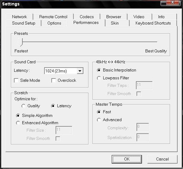

Try this for the RMX in 5.2
And then select the RMX in the sound config menu.
