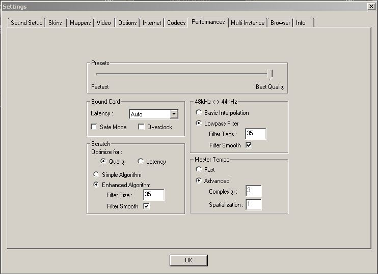

Can you try this settings?
This is from my Dell desktop and it works very good. But gives problems on laptops (distortion, slowing down).
I'm using Denon HC4500 (USB) and Presonus Firebox (Firewire) and I get about the same performance.
geposted Tue 29 Dec 09 @ 4:10 pm
It's the Spatialization setting thats doing it. 0 is designed for real time timestretching; anything above that is much much more taxing to use in real time.

I always use advanced master tempo and key lock because it's essential for harmonic mixing.
Default max settings might cause problems in sound skipping unless your soundcard and laptop are very powerful.
I have Fujitsu Amilo 3650, 2,2mhz dual core processor , memory 4GB, nvidia geforece gt 240m and windows 7 laptop + vci-300 controller.
My settings are:
sound card auto
safemode unticked
overclock unticked
48khz <> 44khz
basic interpolation
Scratch
optimize for quality
Enchanced algoritm
filter size 11
filter smooth ticked
Master Tempo
Advanced
complexity 3
Spatialization 0
It is less cpu-demanding settings than the default maximum but I can hear no audible difference to maximum settings. VDJ works very smoothly, no skipping even if I backspin both decks at the same time (with big vob videos loaded).
