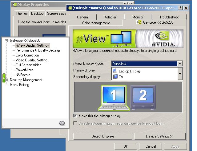

When you go to the nVidia Control Panel ... look for the option that says "Setup Multiple Displays" ... when you select this you should have the "Configure independently from each other (DualView)" selected.
If you have the older Control Panel interface then this option is found under - Display Management
geposted Sun 31 Jan 10 @ 2:05 pm
this is what i have.
geposted Sun 31 Jan 10 @ 2:18 pm
OK, that looks correct ... how about leave everything connected and do a reboot. Does it now work correctly ?

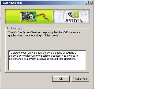

ok, i uninstalled and reinstalled the video driver and got this weird message for a laptop
and also now get the error in vdj when selecting output for video to my tv "error in the video driver". I swear I have the wrong driver but if I go to Dell and put in my service number it only pulls up that one driver. That pic looks like a tower card.
geposted Sun 31 Jan 10 @ 3:07 pm
Ok, I found what the error in video driver was. My output resolution was set too low, when i changed it, i can now load video output to my tv in vdj.
