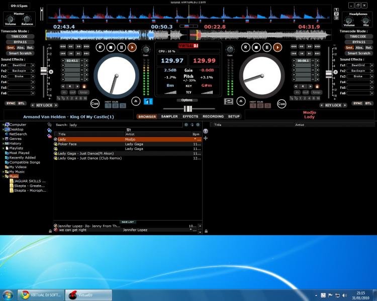

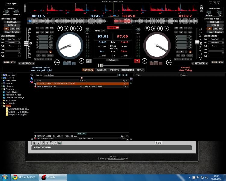

As you can see, the song on the left, in blue (J-Lo), the square's are aligned up under the beats. Where as on the right, in the red, the red squares are no where near aligned.
if i remember correctly, these are only for a visual, they don't actually guarantee where the beats are.

i see what you mean.. but on your example the dots arent connected to each other neither the beats..
basically if i have 2 songs that were the same bmp they wouldnt beat match.. ( even if they were different bpm they would still match correctly)
but they did before i upgraded.. the dots or (squares) are in between the beats not in line with them like they were before i upgraded..
its quite annoying.. if it was always like that then i could understand/get use to it. but because it wasnt like that before i upgraded it quite annoying!

You see above, both songs have a square underneath the beat, and they match up lovely.
