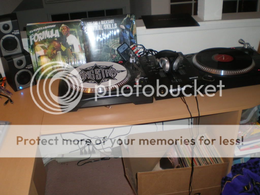

Here’s a pic of my setup so you can see what I'm working with.
http://i435.photobucket.com/albums/qq77/Vikboi28/P1310160.jpg

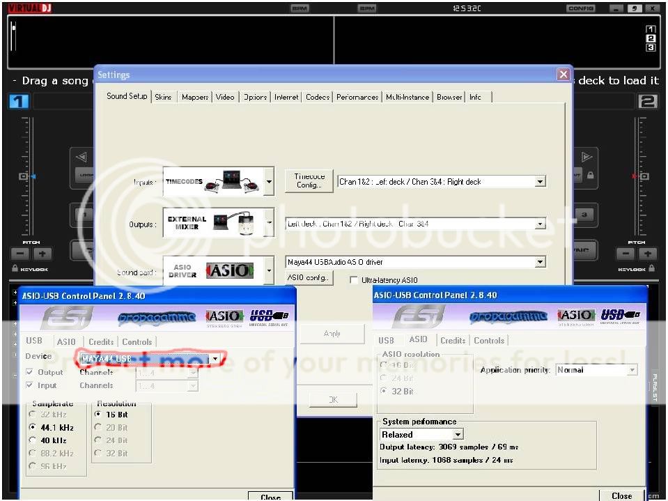

Make sure you go into your asio config and make sure that only the usb maya sound card is selected for the output.

Is this what you mean for the output?
http://i435.photobucket.com/albums/qq77/Vikboi28/o.jpg
