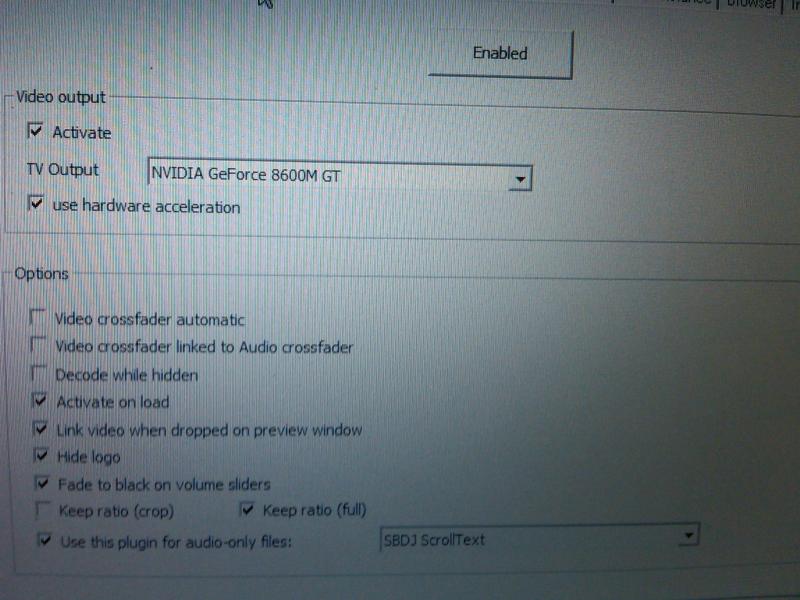

Jimmy, here are some pics that i took of my settings, the first 1 is of the \\\"Video\\\" tab:

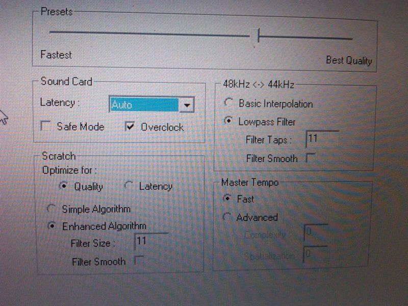

and the second 1 is the \"Performance\" tab:
with my setting like this I have been able to run the "Scroll Text" plugin and the "Sonique" plugin with some scratches thrown in. I will post a video tomorrw night of both plugins running and scratching all at once. This is the laptop I use,
Brand: ASUS G1S, Processor Speed (per Core): 2,200 MHz
Processor Type: Intel Core 2 Duo
Type: Laptop/Notebook Processor Configuration: Dual Core
Screen Size: 15.4 inch Memory (RAM): 3,000 MB
Operating System: Windows Vista Home Premium Hard Drive Capacity (GB): 320 GB
nVidia GeForce 8600m GT Dedicated Graphics Card with 256MB V-RAM, 512MB Turbo Cache
I'm not at all tech savy, meaning I havent really messed with the setting execpt to enable the video out. I hope this helps.

Hi BeatBreaker,
Thanks for posting the info. I spent a lot of time messing with those settings. One question. Are you outputting video to your VGA port? It makes a difference.
If I set my Hardware Acceleration to what you showed... my video on the 2nd player will lock after about 20 seconds. I have to set mine at 3rd notch from the left to prevent lockups.
