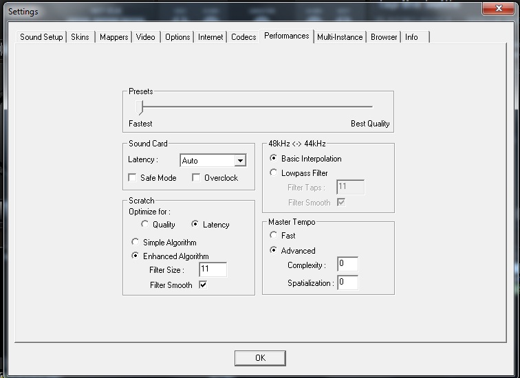

You likely need to adjust the latency settings in the "performance" section of the config menu.
geposted Sat 06 Mar 10 @ 4:13 am
dizzyrocks2001 wrote :
You likely need to adjust the latency settings in the \"performance\" section of the config menu.
They currently look like this...

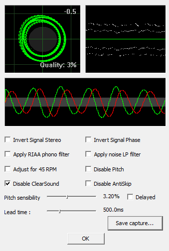

Also you can try playing around with the pitch sensibility slider in the timecode config (I think, it ages since I've used VirtualDJ timecodes) The lower m/s you have the better response I found when I used to use VirtualDJ timecodes. If you go to low then the BPM might start fluctuating on the skin :(
