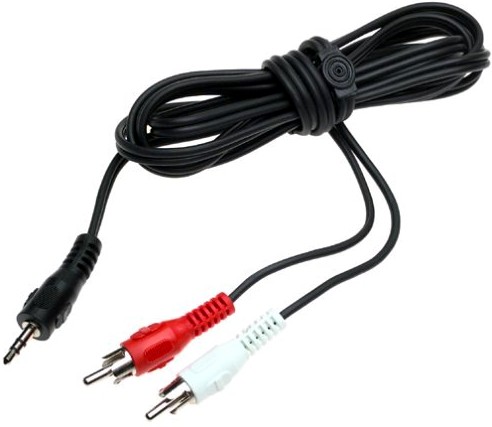

If your target is to mix on the speakers built in the Mac, and if you want to use the features of the Rmx, I suggest you connect a dual RCA male to mini-jack male cable to connect your Rmx output 1-2 to the Mac line input:
- connect the dual RCA cable to DJ Console Rmx output 1-2
- connect the jack 1/8\'\' output to the Mac line input
and you can hear the sound of the DJ Console Rmx in your Mac speakers.
But I think connecting amplified speakers directly on the Rmx output 1-2 would be a better idea.
