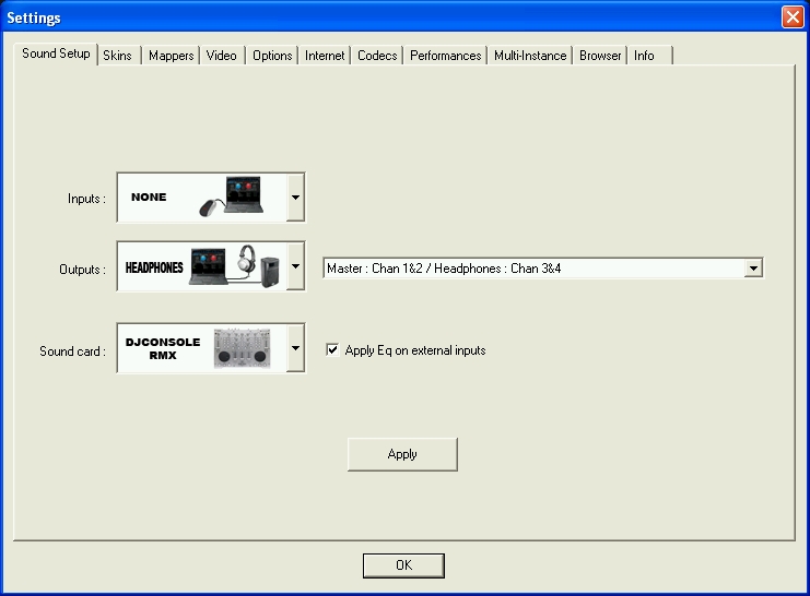

Hello,
I think it is better to connect your speakers to DJ Console Rmx (you still broadcast VirtualDJ on the internet), but if you prefer using speakers wired to the computer instead of plugging them to the Rmx output 1-2, the simplest setting consists in:
1 - in Sound Setup menu, set DJ Console Rmx as sound card for both the mix and the preview in headphones,
2 - connect a cable (a dual-RCA male to jack 1/8 stereo male) from DJ Console Rmx output 1-2 to the line in of your computer
With this setting so the mix is played in the computer speakers, while you preview the music in headphones connected to the Rmx.
VirtualDJ setting in the Sound Setup would be
Inputs: None
Outputs: Headphones
Sound Card: DJ Console Rmx
Master: Chan 1&2 / Headphones : Chan 3&4
Inputs: None
Outputs: Headphones

@kdogg, try this...
geposted Wed 09 Jun 10 @ 7:51 pm
