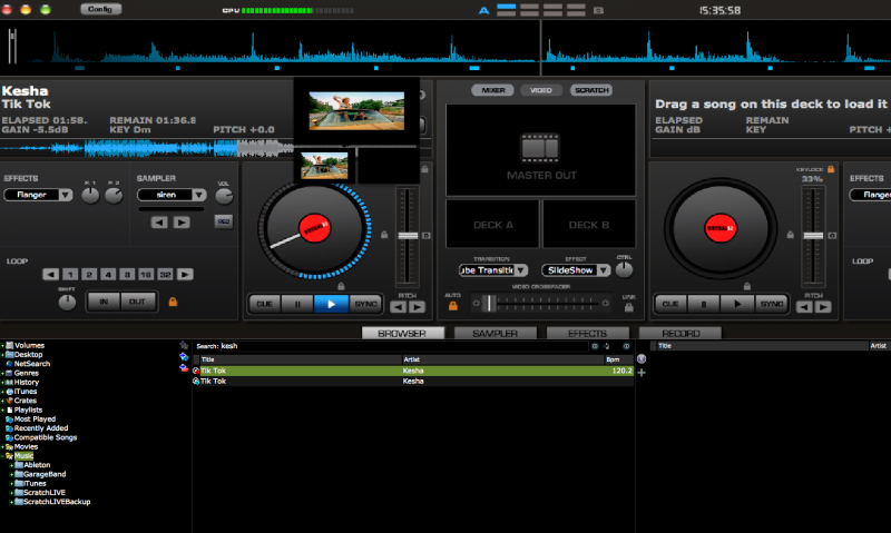

Has anyone seen an issue where if you go from small screen to Maximize to full screen the 3 video mixing screens stay over deck one instead of the middle where they belong? I can not function in small screen when DJing.

I've seen that too. The Video elements are anchored to specific x y coordinates to the original bmp size, not relative to the skin as you are resize.
Just a guess I haven't looked any farther into it but this is how some of the other GUI programs I have used in the past work.
A better question would be how and what to edit to properly resize that skin

Yes that is the question. I have tried every skin and it does the same thing regardless of what skin I use. I really need to fix this or I can no longer use VDJ for DJing. I am doing 2 gigs per week. My iMac is my main system now and I have resorted to using a different program for my last few gigs because I can not resolve this issue. When I am busting butt at a gig I do not have time to squint at the screen to find my next track :-( I have had a ticket open for almost 2 weeks now.

Check the resolution of your screens. Change them to a diferent resolution then change it back to native resolution. Also uninstall VDJ with app cleaner then install it back. That did it for me when I installed 6.0.7

At this point that is pretty much the best option: set your monitor size to more closely match the skin. I have been using the Rusty v2.0 skin for video and it offers the best amount of real estate for search and playlists and is closer to the old program I used Megaseg which had some amazing search organization features and playlist, this skin gets closest while offering visuals for the additional features I want.
