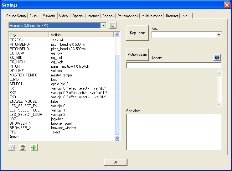

Hello Landpirate,
Can you check in VirtualDJ > Config > Mappers panel, when you display DJ Control MP3 settings, that the key JOG fits with the action jogwheel, as in the enclosed screenshot?
geposted Mon 03 May 10 @ 2:44 am
nah, its set to vinyl_mode 1
ill try setting it to jogwheel

geposted Mon 03 May 10 @ 3:04 am
changing it to jogwheel worked a charm, thanks guys!
