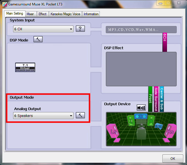

Hi, it's been long since i posted now but now i have finally bought an external sound card (the Hercules Muse Pocket XL LT3) :)
The card works properly for giving sound but i still have the same problem that i can't pre-listen in my headphones...
I installed the drivers but i don't really know if i have to change something in the settings.
Does anyone know how i can get this to work?

Thanks for the answer but i already followed these steps and if I connect it in that way it doesn't give any sound at all.
Hope that anyone can help me. I already tried all the obvious things (I think so) and different combinations to connect the speakers and headphones to the card, but I still only get sound from my master from the dedicated headphones output.
Can there be anything that I might have forgotten?

Things to double-check ( if you may):
- You did install the drivers for the Muse Pocke ?
http://ts.hercules.com/eng/index.php?pg=view_files&gid=2&fid=29&pid=251&cid=1
- You did configure it as the default soundcard for the computer, as well selecting the 5.1 Surround configuration ?
- You did connect your speakers and headphone to the FRONT and REAR output of the Muse ?
- and you did enable Headphone on 4.1 in Virtua DJ.
Technically, if all this was done, it should work.
check
check
check
check
Non-check :(
I just can't find what the possible problem may be... i already reinstalled my VDJconsole and my DJ Control MP3 drivers multiple times, aswell as my Soundcard drivers...
geposted Wed 22 Sep 10 @ 12:19 pm
The only other reason I can think of would be that the Muse would not be in the correct configuration even though it is set correctly in Windows.
Can you open the Muse LT3 control panel and be sure that it is set to 6 speakers?
Once done, if you click on each individual speakers on the right, do you hear sound in your speakers and headphones?

DJ Phatso I LOVE YOU ! ;)))
Tyvvvvvvm , it works as it should now !
