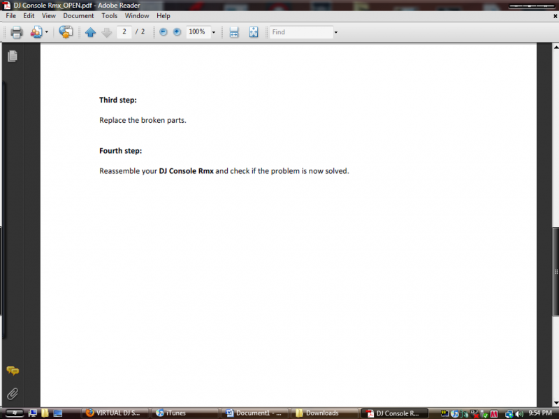

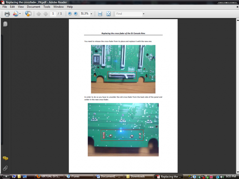

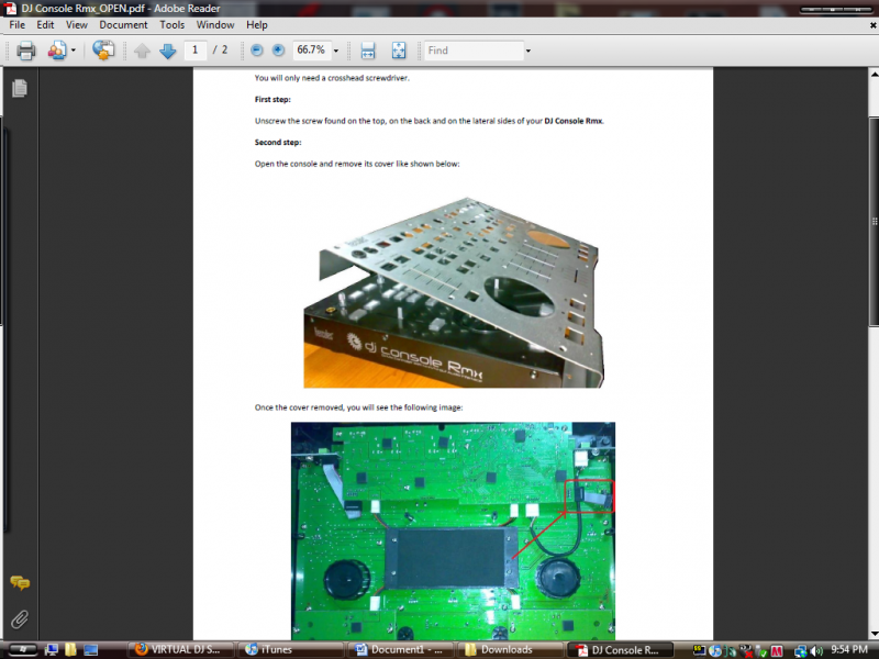

Here are the instructions page by page in their entirety

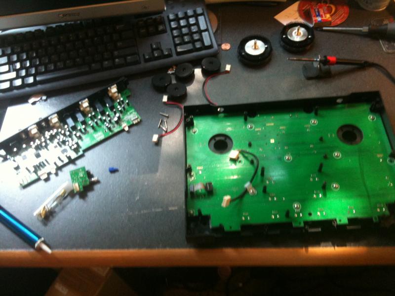

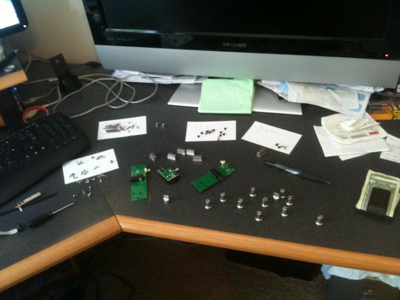

Here is what the process actually looks like

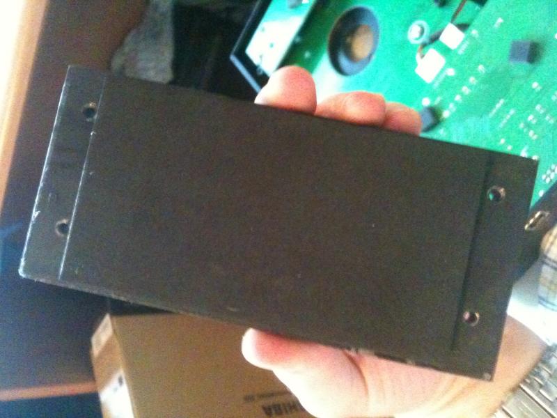

This is the 15lb chunk of dirty scrap metal thats screwed onto the mother board you must remove. I can see no purpose for this weight to be in the RMX other than to make it heavy. I have to say I was very confused after removing this.

sorry to hear about your probs, but you have giving me an idea, that lump of metal (i forgot all about it) is coming out of mine as well, whats the point of lugging it about when it's not needed and the unit is in a combo flight case.
cheers.
cheers.
geposted Thu 24 Jun 10 @ 4:35 am
Absofrigginlutely... Forgot I was carrying that dead weight around!!!

Depending on what's below it, the chunk of metal might be a heat sink to keep the chips from overheating.
geposted Thu 24 Jun 10 @ 12:23 pm
Yeah I will upload then PDF, i have to create an account though. From what I can see the metal is not like any heat sink Ive ever seen. I could be mistaken though. Tech support just e-mailed me and said I need to reinstall firmware so Im gonna try that real fast. Ill update the status of the project later. HAHA and epic post about the dead weight =D

I'm sure I can remember some mag reviewing this before its initial launch and they mentioned about the lump of cold metal just lying there to give the unit a bit of beef.

The biggest problem I encountered when opening the unit is that thee are 5 screws that are only held on by a nut fastened to the opposite side of the casing. Meaning they don't actually screw into anything. When you first unscrew them the nuts drop inside the unit and putting them back on correctly seems to be almost impossible. This is due to the way the metal case, plastic case underneath, and components are layered. So now My unit has 4 holes in it where I couldn't get the screws back in. It would be really great if they mentioned things like this in their instructions for taking the case apart.
**After talking to tech support today they instructed me to take my unit back apart (which took me 3 hours the first time total) and take photos and send them by e-mail. Each e-mail takes at least 2 days for them to respond. UGH. I guess I will continue to battle with them for a replacement unit and play with my handicap one tell then. Wish me luck =)

A few months ago I had to subtitute a potentiometer, cause I through some wiskey on my belowed RMX so I found that piece of metal too. I was told by the technical support that it's meaning is to prevent electrostatic charge and sound distortion, especially when used with external audio gears. I suppose it would be better leaving it where it stays.
