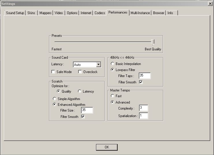

If you want the best sounding keylock you need to copy these settings:
If your computer can't handle it then you should buy another one (Macbook pro for example).

I understand. But fast CPU alone doesn't guarantee perfect performance. I had Alienware $2000 laptop with Core-i7 processor and it couldn't handle VDJ's keylock. Also DPC latency checker never helped me to change anything. Just writing from my experience.
geposted Thu 29 Jul 10 @ 7:54 pm
