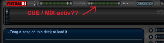

Hi guys , I'm DJRB and my question is how can I listen to just (one side) while the other side is playing without having both sides playing in my headphones? I have the VDJ pro edition as I bought this many years ago and only decide to use it this past year.
I tried many ways and I do have a numark dj controler with an external card and I listen to one side but both sides are playing in and I hardly can hear the one side due to this. I also tried with my regular pc audio sound card and It the same. Can't figure how to configurate this! Is it possible to config this to listen to one side only and how ? Please Help thank you!.

which sound card you use?

I have the 2 in my pc , one I don't use is the original one (HD Audio), but the other one is the Sound blaster Live 24 bit. which I use. I also use this one, the one who came with my numark DJ controller is the Asio card DJIO. I would like to use both options. Thank you for helping appreciate it.

config/sound setup
- none
- headphone
- asio (numark djio)
master 1/2 headphone 3/4
please test this config
- none
- headphone

this is the same config I usually do pryor to work or practice at home and I still can hear the other side, maybe it is normal for the Total Control as the song on the other side is not as loud as the one I'm listening to though.

what skin you use ? do you have cue / mix adjustment ?

I have the latest version of virtual DJ and not sure which skins your talking about, sorry, I use also mix lab 3 once in a while

Hi and yes I did finally figures it out after I tried the cue/mix skin like you had told me about as I was playing with my total controller and went and change my skin to the cue/mix and saw the cue on top and I had to adjust the level, everything is great now, Thanks a lot for your help appreciate this... OMG was I dumm or what LOL , the skin I was using wasn't showing it. Thumbs up for you guys on VDJ. your the best!
