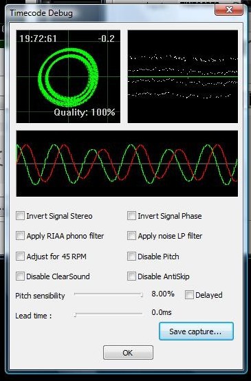

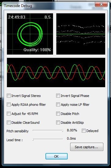

I used to use the RMX alone and recently upgraded my setup to get into turntablism. I am needing some help because I am not sure if everything is the way it should be. Thanks for taking a look...
My setup
Serato CV02 Side B
Technics SL1210M5G
Shure M44-7 (3 grams of tracking weight)
Hercules RMX (switches to phono)
Pioneer DJM-909
RMX ASIO buffer
Timecode Signals L and R
Left Debug
Right Debug
Performance Tab
PC Specs

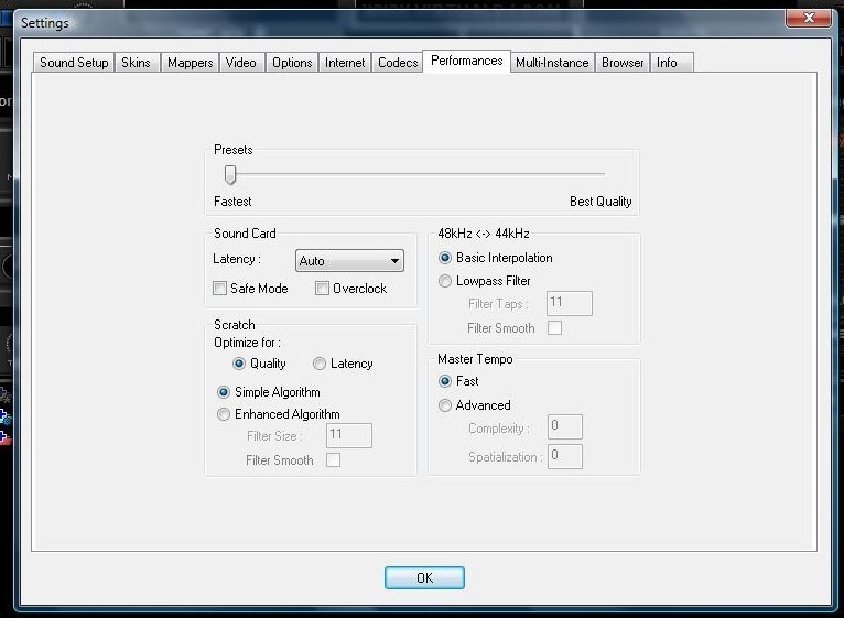

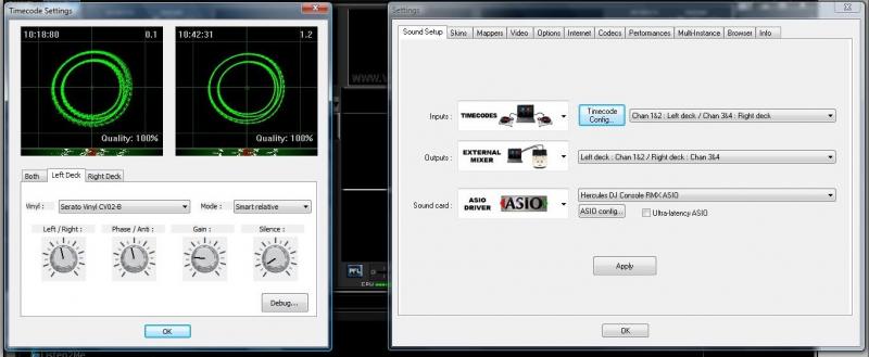

Every 5-10 seconds the Quality (#s just below the timecode signal) drops to 30% for just a split second and I think that leads to the speed indicator (numbers top right of timecode signal) fluctuating +/- 1.0
This makes the song/videos play inaccurately. It almost sounds like I am pitch bending the songs/videos. Is there anything in my set up that I may have overlooked or any suggested hardware that I could swap out? Any help is appreciated.

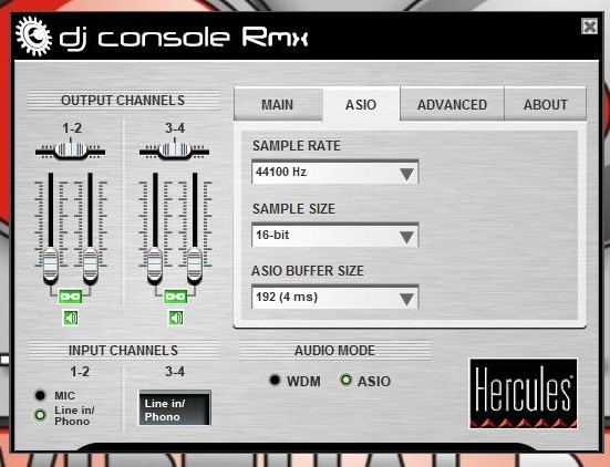

Start by playing around with the ASIO buffer size. Sometimes a step or 2 can make a big difference.
geposted Fri 06 Aug 10 @ 2:35 pm
And adjust the silence knob by double clicking on it
geposted Fri 06 Aug 10 @ 6:05 pm

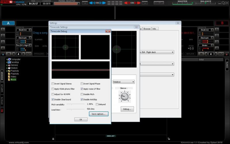

Ignore my pitch sensitivity settings, but check all the boxes on your system that are checked.
Michael
geposted Sat 07 Aug 10 @ 3:34 am
