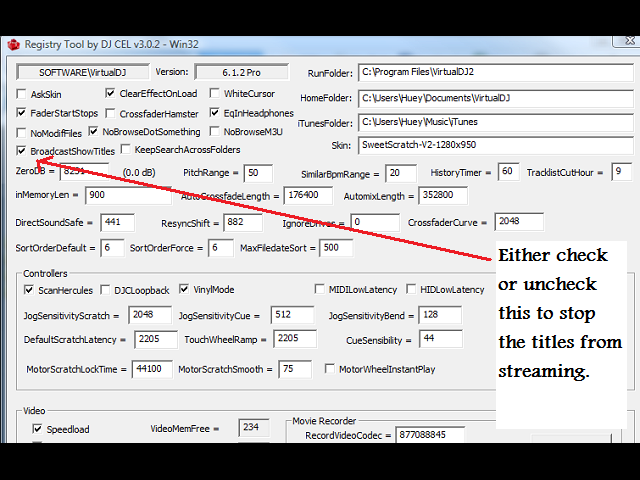

Well I cant really answer your first question cause I have never used 1 let alone even seen 1 in person, lol! But to stop the titles from showing you can download the, http://www.virtualdj.com/addons/2170/Registry_Tool.html. Look at the pic
Hope that help
Huey
Hope that help
Huey

Huey,
Many thanks the registry magic did the job!
Best Regards,
Indy
