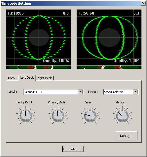

In VDJ Config Sound Setup I choose Timecodes, and that's is what I have in the Timecode config:
Both decks have 100% but the right deck had a very distorted sound and was not useable. The circles are full lines on the right deck and dotted on the left. Does that mean anything?

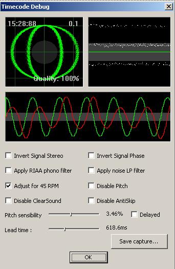

Here's the Debug window;

Hello li125,
1) With a Pioneer CDJ player, I suggest your set the input level in DJ Console Mk4 control panel on Boost.
2) DJ Console Mk4 has only a 4-channel output (2 channel for the mix + 2 channel for the preview). If you want to use a 3-line mixer, you must either use a 6-channel sound card or add the stereo output of your computer built-in sound card (but combining 2 different sound cards generally drive to more latency than 1 sound card).

I din't try Boost, but why is 1 deck OK and the other not then with my Pro settings?
I think it is also possible to have Ch1-2 for deck 1 to the DJM800 and also Ch3-4 for deck 2 to the DJM800. Then I can use the monitoring on the DJM800, no?
