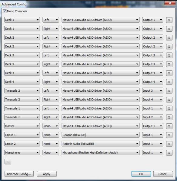

Okay, maybe I phrased my question incorrectly, please allow me to try again. I have a Vaio laptop running Vista, I have a Numark DMC2 controller and a Numark C3USB mixer. I downloaded the VDJ7 and having no luck running 4 decks. Should I be able to run 4 decks with this set-up, or would I need 2 more soundcards? If so, how?

I think my main problem is, it won't let me config my ASIO driver. Can in 6, can't in 7. Anyone know why?

Yes, I click on the new skin with 4 decks and ASIO tells me that there aren't enough channels. I can go to config and "ASIO Config" and can't get into my config for ASIO. If I go to two soundcards, I get two decks. I can ignore the ASIO warning and get the skin with 4 decks, but none of them will play. Thanks for your help, Soulman, but it's very confusing.

Crash you have to go into advanced config and set it up. I\'ll try to make a video of how to do it but I\'m just using a maya44 and I have it split into 4 channels. Should be some what the same, just the names are different.
So you only need 1 soundcard. Each channel on your soundcard gets split into "2",
Output 1, Left out (white) being channel 1 and Right out (red) being channel 2
Output 2, Left out (white) being channel 3 and Right out (red) being channel 4
Pretty much you split it into 4mono channels but when you config make 2, a Left and a Right (Look at the Picture) its easier then you think.

Heres a picture of my config, everything you see is routed into a 4 channel mixer, not the mic though.
If this isnt what you need I'm sorry

Huey, that is absolutely what I needed. I didn't see how you got into the advanced config. I'm playing on 4 DECKS!! I still have a bit of tweeking to do and figure out a bit of mapping, but I'M PLAYING ON 4 DECKS!! This is cool. Thanks to all who helped.
