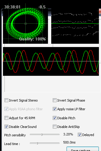

i took a snap shot of my signal for some one to take a look at.
i use vdj 7, a SL1 sound card, and serato tcv\'s
wierd thing is they both read 100 percent, but every 3 minutes or so it dips down to about 0-30 percent and u hear the music go all crazy backwards and fowards for about 2 seconds... my right deck dosnt seem to be doing this tho only the left... and ive switched needles from left to right, also even my tone arms i switched from left too right.
also... only comming from my left deck when i bypass timecode to play my real vinyls, it makes about 5 or 6 beeps. which is wierd because if i play real vinyl with out vdj loaded these beeps dont happen. im very confused and could use some help on this matter.

could it be my sl1 soundcard? or perhaps i need new needles?

how bout the rcas? try ur sl on another pc and see what happens
geposted Wed 03 Nov 10 @ 7:37 pm
i took out the rca's blew in the jacks, and weighted my needles.... i also switched from a s-tone arm to a straight tone arm... and now it worlkds great.

Glad your all sorted but you still never found the problem. I mean you did all these things but did you try it after you blew out the jacks, if that didnt work did you then redo your needles?? Know what I'm sayin............dont know if it was the RCA's or the needles........
