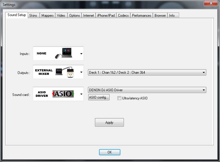

I am experiencing the same issues, Yesterday Virtual Dj crashed at least 20 times while I was in Hybrid mode. For whatever reason whenever asio pickup the 1600 in hybrid mode it does not pick up the 3700's. In regular midi mode everything works great, but what the point of having hybrid mode with a native player and you cannot use it. I would like if any who has figured this for their assitance.
1. Is the 1600 suppose to show up as a sound card in the drop down menu in the soundcard selection in Vdj.
2. How do I route the channels in the 1600 correctly to get the sound working while using my 3700 time code in Hyrid mode che.
3. Do I have to change any settings in USB-A USB-B mode to assign channels.
4. Please post pictures video and clear information if you can my experimentation with this has been really hard. Thanks
