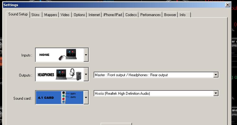

In order to have master output and prelistening with headphones, you will need 2 stereo-chanel outputs. A 5.1 sound card is good enough to do your job. There is no need to have a second sound card. Even in case of using an external mixer this 5.1 card is still able to route 2 decks in a mixer and be able to prelisten from the external mixer.
This should be your sound setup
If this sound setup still doesnt work for you, you will then have to check your sound card configuration, make sure your cables and connections are correct.
