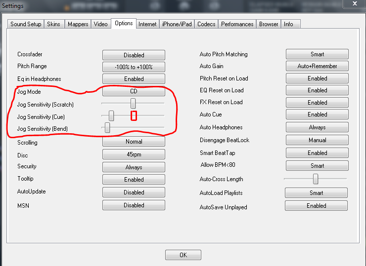

Hello. Try to play whith jog settings a little bit:

As above, set the Jog Mode to CD.
If it still scratches, then you may have an older mapping installed.
You can revert it back to the factory defaults by going to CONFIG -> Mappers, choose the DAC-3 in the drop-down list and click the reset to factory settings button at the bottom-left of the Mappers dialogue box.
