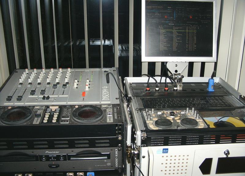

Hi GroovinDj,
I use a Terratec Aureon 5.1 Sky and the mixer i use is a D&R Discom 4.
Well it does not matter what i configure,
if i set deck 1 to channel 1&2 and deck 2 to channel 3&4. (like the old external mixer config)
Or if i only use master to channel 1&2 the result is the same.
Asio or wdm does not matter. On board sound (just the same!).
If i use the external mixer config all is running like a charme, with 2 deck\'s but if i want 4 or 6 deck,s i will have to use advanced config.

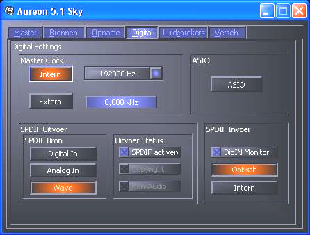

@groovindj
"from the terratec website:
Does the Aureon 7.1 Space / 5.1 Sky work together with Cubase VST from Steinberg?
Answer 10:
Yes. Especially by using the ASIO 2.0 driver very low latency time will be possible.
As i mentioned before "the card has ASIO and performs with the lowest possible latency settings in VDJ, really well!

@groovindj: Although I think you are right, I understand that Klaas is missing your point. If the card is working with the old audio-setup, you might expext it also does with Advanced setup, no matter how old that card is.
BTW: In the manual I found 1 clue that the card supports ASIO:

@Martin,
Thank you!!! This helps, ASIO4ALL works!
So it must be that Advanced setup is conflicting with the (older) ASIO driver from the Terratec Aureon it self.
