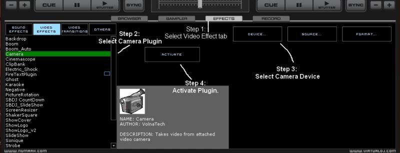

OK to use Camera Plugin:

The camera plugin probably hasn't been ported to Mac yet.

Ah that stinks that the camera function is not supported on the mac...I did switch to a PC and I do see the plug-in for the camera....however, I bought a 720p camera to get HD video through the camera of the crowd but maybe it is the plug-in that I see listed.
AUTHOR: VolnaTech
Would anyone know the version that VDJ supported HD or would it be the plug-in that I am using or maybe it is showing 720p but under the Video Format tab you can only STREAM up to 640x480?
AUTHOR: VolnaTech
